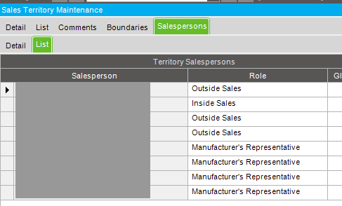

Not sure if you’re aware, but there is built in logic that hides/shows customers in many screens based on the territory setup. There is a View All Territories checkbox on Work Force and that essentially says yes, show this sales person all territories or no, only allow them to see the customers within the territory that they are a member of.
So within each work force, authorized users are assigned. And logically, if you are not an authorized user of a work force that can see all territories, you will only be able to see the customers within territories that the work force is a valid salesperson for. Finally, and this is where I think your situation may be in, if the territory is inactive, it probably hides customers assigned to that territory from everyone (maybe even if the view all territories checkbox is checked on your Work Force that you are a user for). Clear as mud? I am thinking this might all be part of what’s going on. Customers will just not show up in BAQs, dashboards, customer search, etc.
