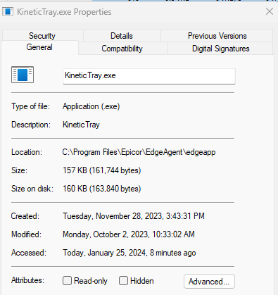

Anybody know what the edge process is in task manger? I don’t have edge in the tray so need to end task but how ???
My shows as Kinetic Tray, but I’m still on 2021.2.
I can confirm it still shows as KineticTray in Task Manager
