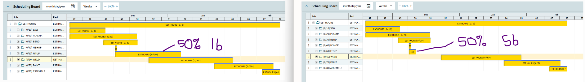

I know this thread was created a while ago, but just chiming in to say that we experienced the same strange gap with the send ahead. We’ve figured out, at least in our case, that the send ahead is not taking into account scheduling blocks set in the job operation’s scheduling factor. If I set the send ahead operation scheduling block back to 1, the scheduling board starts to behave predictably. For now, we’ll continue to use the scheduling blocks to squeeze the duration of the operation, but adjust the send ahead to a higher percentage (or was it hours?) to get the next operation to move up the start date.
