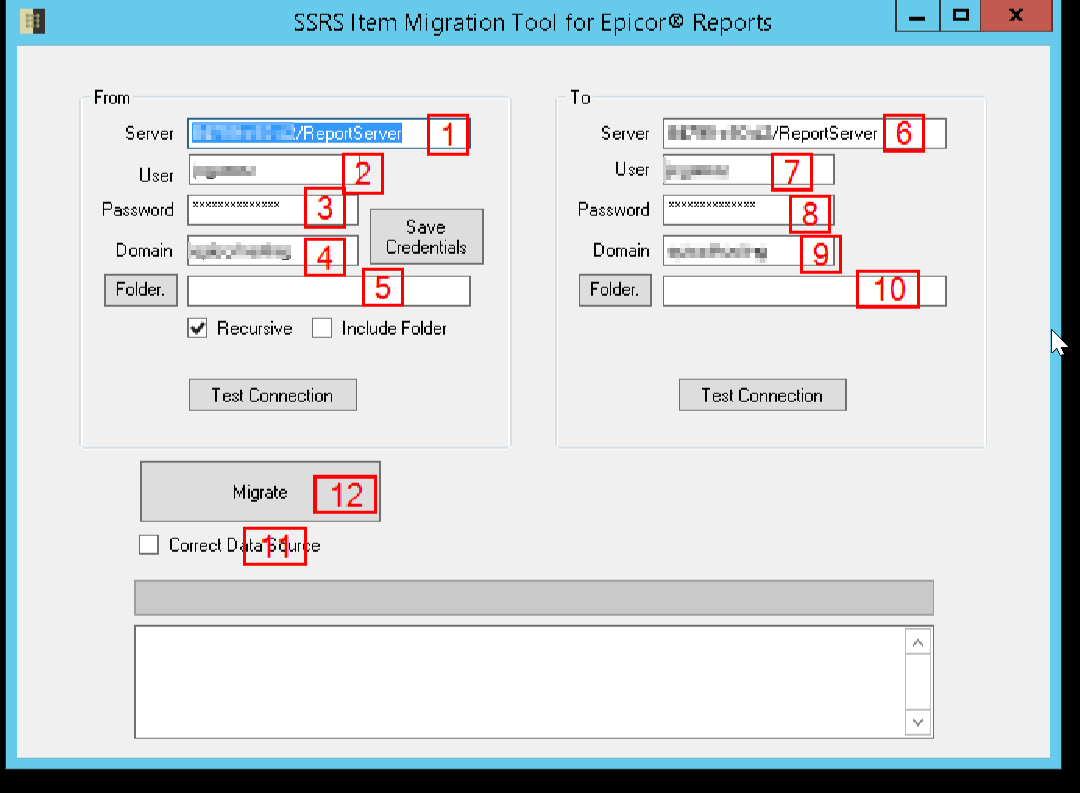

  • Enter the from and to info requested
  1. From Server Name: Is the Server Name of the SSRS App Server you’d like to copy from (server.tld.local/ReportServer)
  2. From Server UserName: Windows Domain username of an account that has access to the above
  3. From Server Password: Windows Domain password of an account that has access to the above server
  4. From Server Domain: Windows AD Domain of the above account

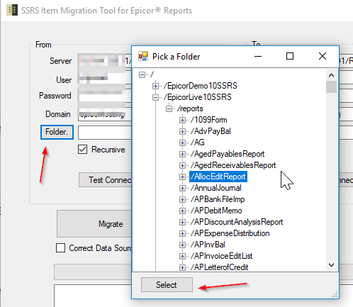

  5. From Server Folder: Will allow you to select the folder you want to migrate
  6. To Server Name: Is the Server name of the SSRS App Server you’d like to copy to. It can be the same server or a different one (server.tld.local/ReportServer)
  7. To Server UserName: Windows Domain username of an account that has access to the above server
  8. To Server Password: Windows Domain username of an account which has access to the above server
  9. To Server Domain: Windows AD Domain of the above server
  10. To Server Folder: Will allow you to select the folder destination of where you’d like to copy the SSRS Report To

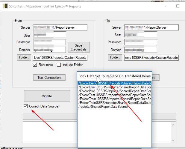

  11. Correct Data Source: Allows you to change the data source of the destination SSRS Report to the correct one. Click it and select the “TARGET” data source that you’d like the destination reports to point to

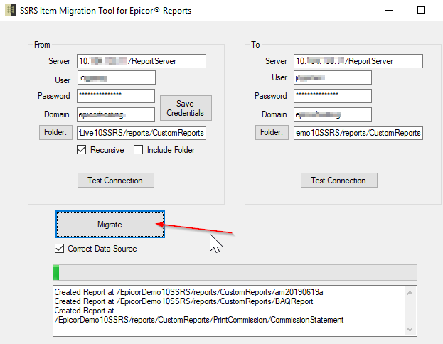

  12. Click Migrate
Recursive checkbox will copy all subfolders and sub reports found in the selected folder
Include Folder you shouldn’t need to check this, it creates the entire folder tree structure in the target.

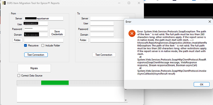

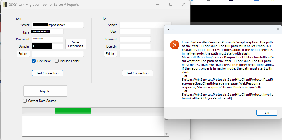

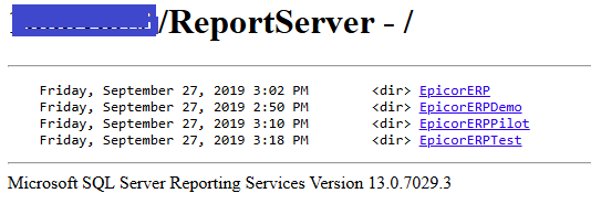

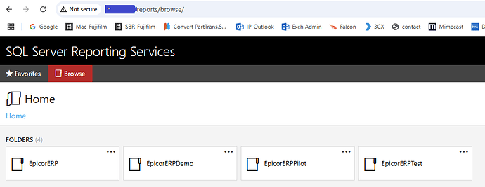

Hi,
We are currently upgrading the E10 to K2024…2 and looking for tools to migrate the custom SSRS report to the new Kinetic instead of manually download and upload one at a time.
I tried the tool and did a test with error. Wonder if any one can advise where I did wrongly.
The test connection show error but when I test the server on a brower I am able to login to my on prem epicor.
I’m guessing pretty much what it says on the error. If you’re sure your credentials are correct by testing them some other way, then make sure the points in the error are adhered to. Test with and without recursive, put a path in the field, etc. Show us screen shots of everything try so we can see what’s going on.
I’ve stress-tested the heck out of this tool and it’s never let me down without a valid reason.
