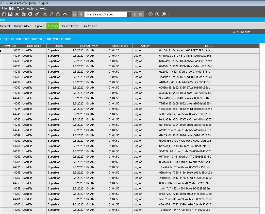

Does anyone know what would cause the application to record the below login values for an end user? This is the zSysActivityLog BAQ results. This table is populated as a result of the Sys Activity tracking setting being selected in Company Maintenance, so I am assuming there is somehting wrong with the way the application is tracking Logon/logoffs.
Thanks,
Jason
Check if there is any schedule process in Service Connect, RESTful API, etc trying to login.
oh you know what… I did not think about that. The Generate PO Suggestion Process and MRP runs are both set to my USerID. Totally forgot about that.
Thanks for the reply, I appreciate it.
