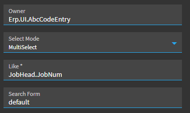

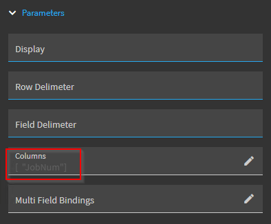

Hi there! If you set it up correctly, you will automatically get a character separated list from your search.
Parameters say [“JobNum”]
if you don’t like default separator (~), you can play with different options in the Row Delimiter
Hope this helps
Thank you so much!

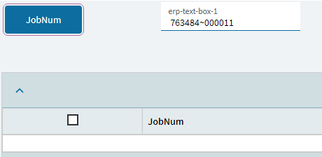

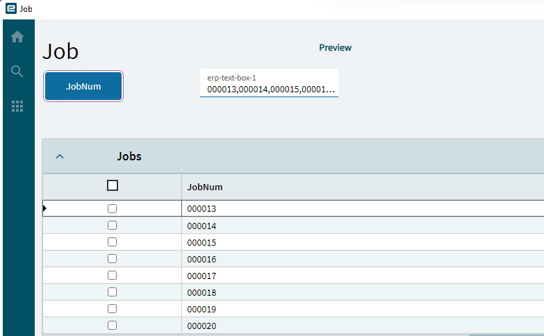

Followup question for me and others who may get into this:
My search multi-select works as shown in the textbox:
When I select one item, my BAQ (that has a list parameter setup)
Runs and returns a row without issue:

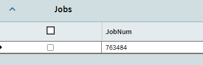

When I select multiple JobNums, it fails. I get no records:

When you select multiple jobs from a quick search or something similar? is that what you’re saying?
Correct, I apologize for not being clear there. I click a button that opens a multi-select search. If I choose one JobNum, it works. If I choose more than 1 it completely fails (no rows populated) even though I’m seemingly passing in the value with the ~ delimiter. I’m on the verge of just building a function :sweat_smile:

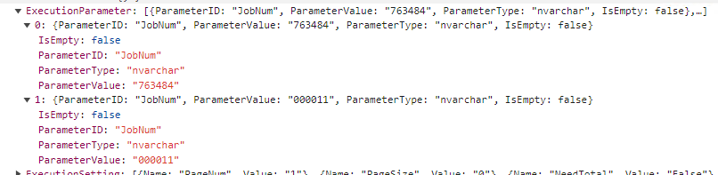

Excellent question! I ran a trace and there is no list. Instead, the payload shows an an ExecutionParameter for each job selection:
I couldn’t find a delimited list being sent. Will the JSON Editor allow things like constants to build a list to loop through adding an ExecutionParamer for each? So far, I’ve had no luck.
That trace is from your setup described in you first post? Meaning that what happens when you exec BAQ {TransView.Jobs} ? Or that’s a trace from the working test like after providing a list in BAQ designer.
Another good question :flushed_face: Trace came from running my BAQ in BAQ Studio/Designer.
Huh. And it worked? You got the expected multi-job results? I’m suprised, just never seen the same parameter name/value provided twice.
If that’s indeed how ‘list’ type params are handled, I think you should change the param type to simple string, keep the IN() criteria and use one of the methods to concat a valid IN string above.
I’m not aware of an easy way to make it ‘expand’ a list into many params like BAQ designer is doing. I’m sure there’s a way but I don’t know it.

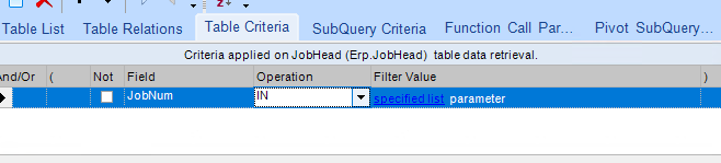

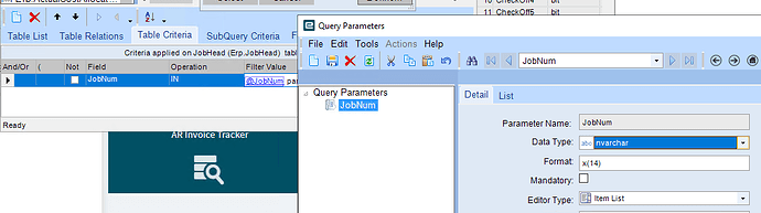

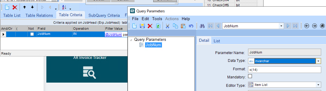

On the BAQ criteria: If I use the IN operation, my paramter must be a list type:
Looks like I can’t change it to a string.
Okay then I was wrong. I’m pretty sure the IN operator can take a single-quoted, comma delimited list via one of the option outlined above.

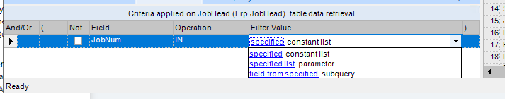

I’m not sure tho whether this is being complicated by the fact that you’re using a param and thus forced to call via rest-erp rather than baq action. But I’m curious whether one of the ConstantList options (non-parameter) makes a difference.
Don’t have time to test it or find a working example at the moment but I guess my approach would be:
  1. figure what works for passing to IN() without using parameters then
  2. figure out how to make that work with parmeters

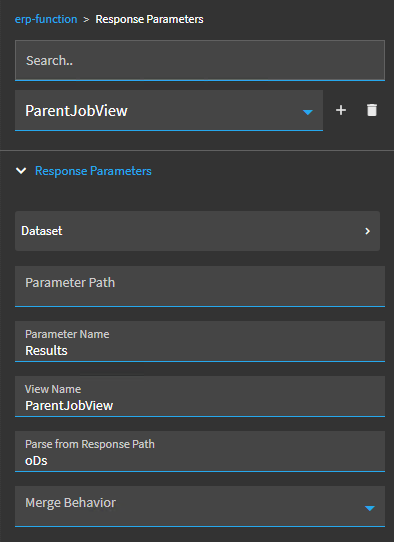

Well, sorry to disappoint, but I just created a function instead. Unfortunately, time is my enemy today :face_with_diagonal_mouth:. I created a function that runs the same BAQ that has the pesky list parameter:

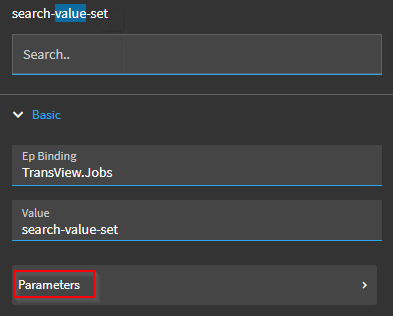

After the user selects the jobs they want to see, I pass their selections to my function using {TransView.Jobs} as populated from search-value-set that @nikba showed me, using the Row Delimiter ,
The function runs my BAQ, as shown below and returns the dataset (oDs):

I then pass the result to the dataview my grid is bound to:
Probably not the solution hoped for, but this direction does work. The function adds an ExecutionParameter for each jobnum the user selects, just like my trace showed when I manually ran the BAQ. Perhaps you can create a loop in the JSON editor and create an ExecutionParameter for each selection? I don’t know, but if you can do that, I’d definitely go that route over doing it this way. :man_shrugging: I just didn’t have time. If I shake something else out, I’ll be sure to update.
