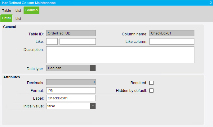

I am sure it does. It is in the UD table in SQL and the tables show that they are in sync.

Can you look in UD Field Maintenance and make sure you do indeed have that field defined? also it may be case sensitive… It may be Checkbox01
This is what is showing up in the UD maintenance. It is exactly the same as in 10.1.400.38.

Your screenshot shows that CheckBox01 exists on the OrderHed_UD table, but isn’t your code above creating a new QuoteHed row?
