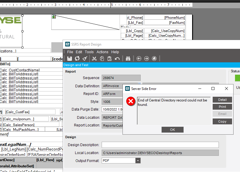

Then, I Insert Image of the same jpeg I’ve been using in ARForm for years in to the Header area and I get an error:
I don’t know what this means or how to fix it.
Error- End of Central Directory record could not be found.
Please help!

I get the exact same message. I do not have to do anything. Just do the download and then preview.
Error message.
DaveO
