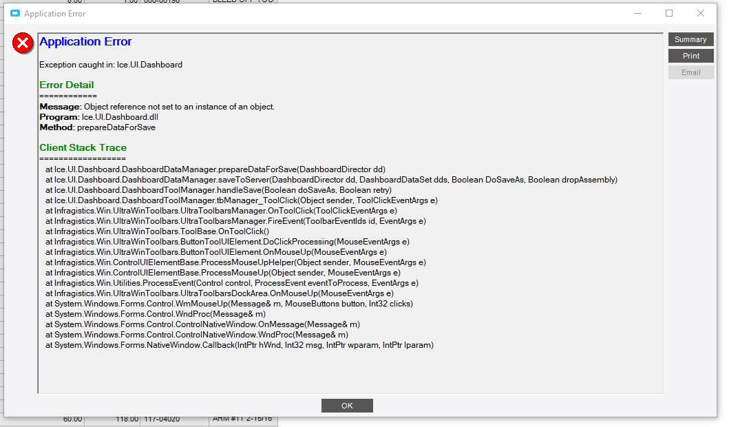

Error: Object reference not set to an instance of an object- Dashboard save
Every time I click the save button on the dashboard designer I receive this error.
After I close the error I am not allowed to make any changes. This only occurs for this one dashboard. On other dashboards, I am able to make changes and save. What could be the issue? Could it be a bad BAQ? This error doesn’t give me much direction as to what went wrong. I have seen it a few times while doing customizations but not here.

Nancy,
I wouldn’t think it is a privileges issue as I am able to save changes to similar dashboards. I am also able to test and deploy them. It seems to only be this one that the error is occurring.
Unsure of what was going on here. I ended up just recreating the dashboard again using a new dashboard ID and using the same BAQs. I can now save it just fine.
