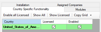

I don’t believe there is anything to install for US CSF. You do however need to enable it in the Administration Console in the Licensing Section of your App:
Right click Properties
yes that is installed and has been while we have been on 10 for the longest time. Also this is an upgrade from 10.2.700 to 11.2.200.7
We upgraded from 10.1.600 and we had to enable it.
