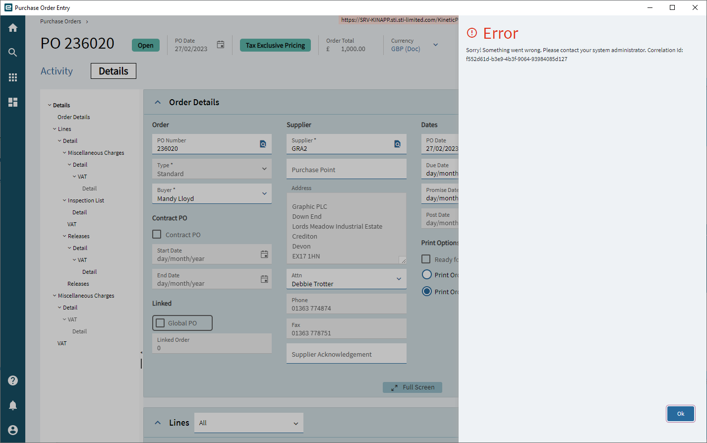

Any idea how to decipher these errors?
I am getting this when saving a PO Header or making a change to an existing PO in our Testing environments. I have removed any custom layers and switched off BPMs but i am still getting the issue. We recently upgraded the environment to 2022.2.8 and before that it was working fine. I am at a loss and guess i will need to raise a ticket with support. :roll_eyes:

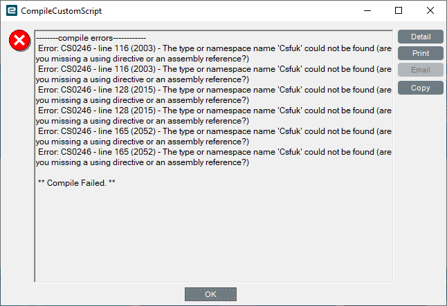

Company Config gives me this so it looks like it is the right issue
@hmwillett Turns out that like the Kinetic Layer Customisations being removed when you do a major update (Which i have raised a ticket with support but it seems to have stalled in where it had got), CSF files also are removed and you have to add them again. We have found two on EpicWeb but unsure which we have to run (Support ticket also raised).
This is not a very good process that when you upgrade you have to try and find out which ‘extra’ things you need to do to ensure your system is fully updated. @timshuwy I have asked my PM to escalate this issue but surely the upgrade process should cover all things that need to be upgraded, customisations i would have thought would have been a key thing?
It’s 100% related to the UK CSF pack. I think the main install guide does reference installing any CSG packs from memory.

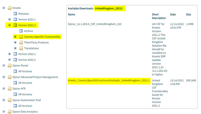

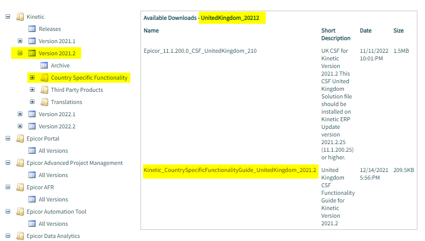

There is a good guide for installing the CSF UK pack - walks you through every single step. The only gripe is that the documentation isn’t listed under the latest version on EpicWeb. Browse back a couple of versions until you find the CSF Install/User guide, the steps haven’t changed. Shout if you need me to send a link to the EpicWeb document.
Mark,
Any idea which one we install or both?
Both - but you do need to read the install guide. It’s not just a case of installing by pressing Next, Next, Finish. One has to be installed only once, then not in subsequent companies. There are other steps in the admin console such as Scripts runner and extension sync.
