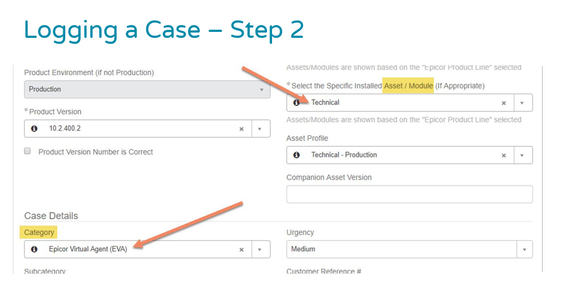

Chris, thank you for opening a case. Tommy, I also think you should open a case, if you could. Please make sure when you open the case you enter “Epicor Virtual Agent (EVA)” under Category and “Technical” under “Select the Specific Installed Asset/Module (If Appropriate)”. Thanks!
Also, enter **Support at the EVA prompt to save and capture the ID of the conversation to give to Tech Support. Thanks!
