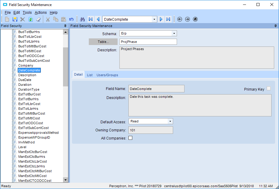

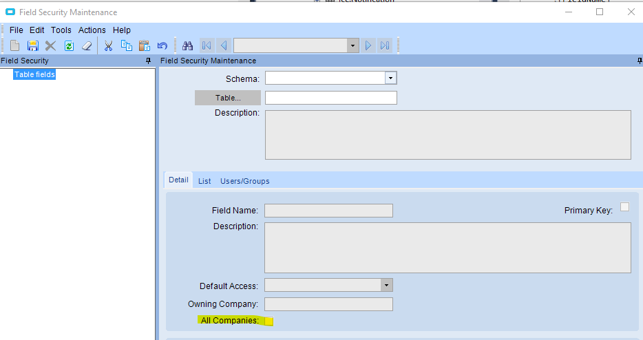

Hi @kfierce
This is possible (not sure what version it was introduced) now, at least in 10.1 and 10.2. You can set the field security for all companies or each individual company with this checkbox.
