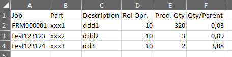

Expected output is:
2021-06-11 11_38_20-prwez0pl.p5e - Excel

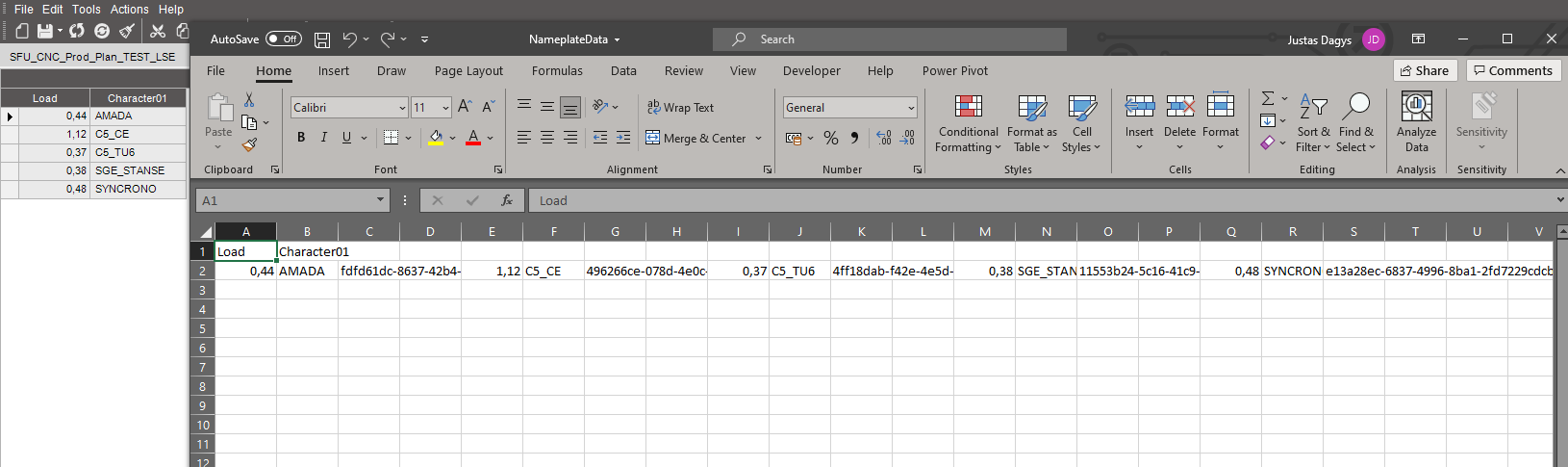

Here is the code i’m using for my own purposes.
private void EasyButton_Click(object sender, System.EventArgs args)
	EpiDataView edvPP  = (EpiDataView)(oTrans.EpiDataViews["V_kpNameplateData_1View"]);
	using (System.IO.StreamWriter sw = new      System.IO.StreamWriter(@"C:\temp\NameplateData.CSV", false, System.Text.Encoding.UTF32))
		char ctab = '\t';
		string stab = "\t";
		string newline = "\n";
		string[] headerList = {"model", "serial #", "Rating"};
		string header = "";
		string detail = "";
		header = string.Join(stab, headerList);
		sw.Write(header + newline);
		foreach (DataRow dr in edvPP.dataView.Table.Rows) {
			foreach (var ay in dr.ItemArray) {
			sw.Write(ay.ToString() + "" + ctab);

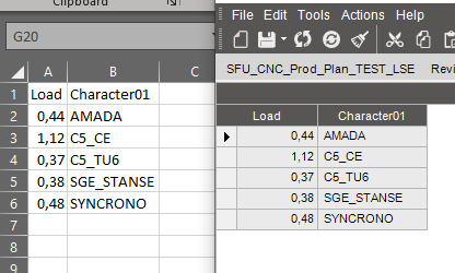

Hi,
This is basicaly almost a solution. Just one question, maybe you know fast answer. if view contains more than one row. How to jump to new line every time when row reaches the end, is some count needed? And how to ignore sysrow, do i need to point code to exact columns which are needed?
Ok figured out how to jump to new line on each row(added \n after first loop instead before), but can not get rid of sysrow

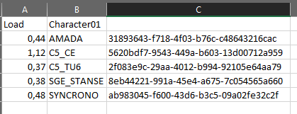

@kylepbsps thanks for code.
Finally solved the puzzle by combining your code with some additional scripts. Don’t know if this is the best way, but seems now I can get only needed rows splited per line and without sysrow.
private void epiButtonC1_Click(object sender, System.EventArgs args)
EpiDataView edvPP  = (EpiDataView)(oTrans.EpiDataViews["MyView"]);
	using (System.IO.StreamWriter sw = new      System.IO.StreamWriter(@"temp\NameplateData.CSV", false, System.Text.Encoding.UTF32))
		char ctab = '\t';
		string stab = "\t";
		string[] headerList = {"Load", "Character01"};
		string header = "";
		string detail = "";
		sw.Write(header);
		foreach (DataRow dr in edvPP.dataView.ToTable().Rows) {
                sw.Write(newline);
			sw.Write(dr["Calculated_sum"].ToString() + "" + ctab + dr["UD02_Character01"].ToString());
