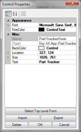

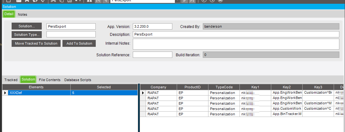

You can use the solution workbench to export personalizations. I would imagine importing them should work too. (I haven’t tried it though)
The use can do it under Tools->Personalisation as shown under:

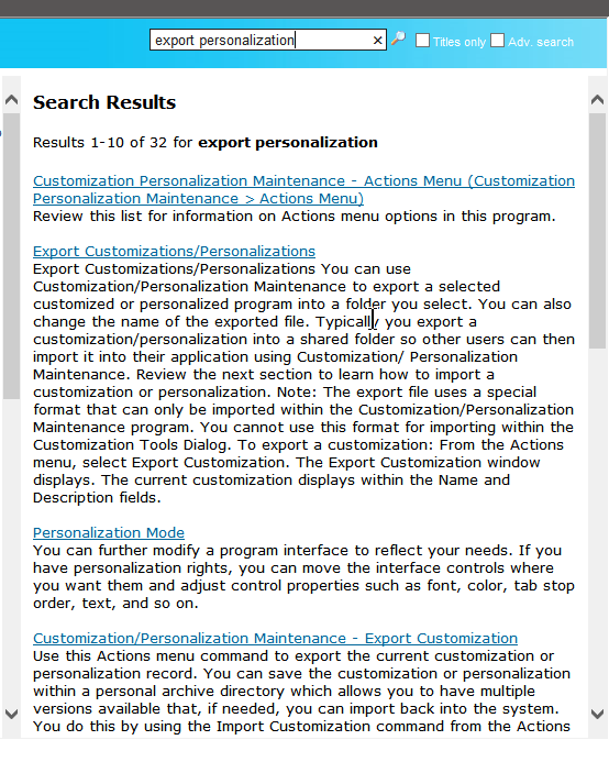

@tse.dba, make sure you search the help when you have those kind of questions. There’s a ton of stuff in there!
