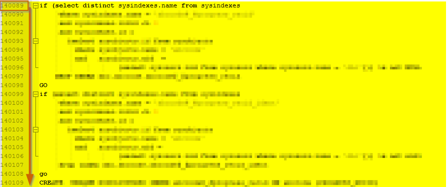

If one were to install V803 SQL, they would find a .sql file in mfgsys803\db\newdb that allows ones to create a new empty Vantage/Vista 8.03 SQL database.
If that person were to go to line 140089 in that .sql file and copy everything to (and including) line 230051, one could create all of the standard Epicor indexes against a database that has the same schema as a standard Epicor Vantage 8.03 database.
I’ll send you the mfgsys803.sql in a message shortly.
