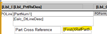

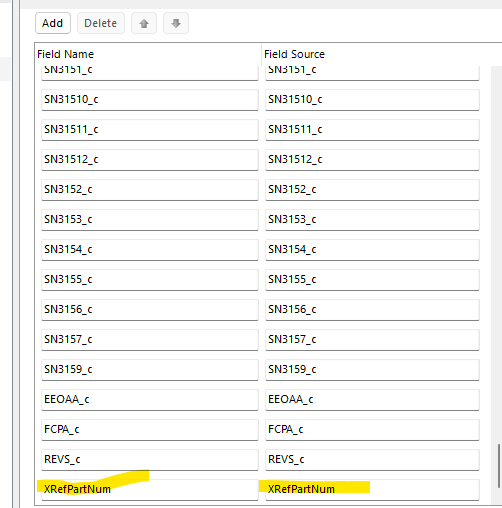

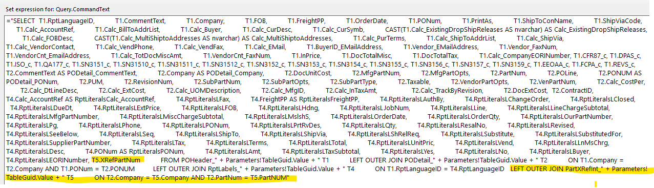

My engineers have added internal cross reference part number into Kinetic for a number of parts and they would like them to show up on the PO form. I copied the RDD for the poform and added the PartXRefInt table to it. I removed the exclusions from the fields I needed and setup a relationship with the PODetail table. I then set up a new Report Style using the duplicated RDD and downloaded the style. I updated the query in Report Builder to pull in the table and the fields I wanted. The report saves in Report Builder and it runs just fine, but it isn’t pulling in the information into the field. I made sure that there was an internal Part Number setup for the one I chose, so I’m kinda stumped at this point. I’ve done this before without problems, but this is the first time in Kinetic, so I’m wondering if I’m missing something. Screenshots attached.
