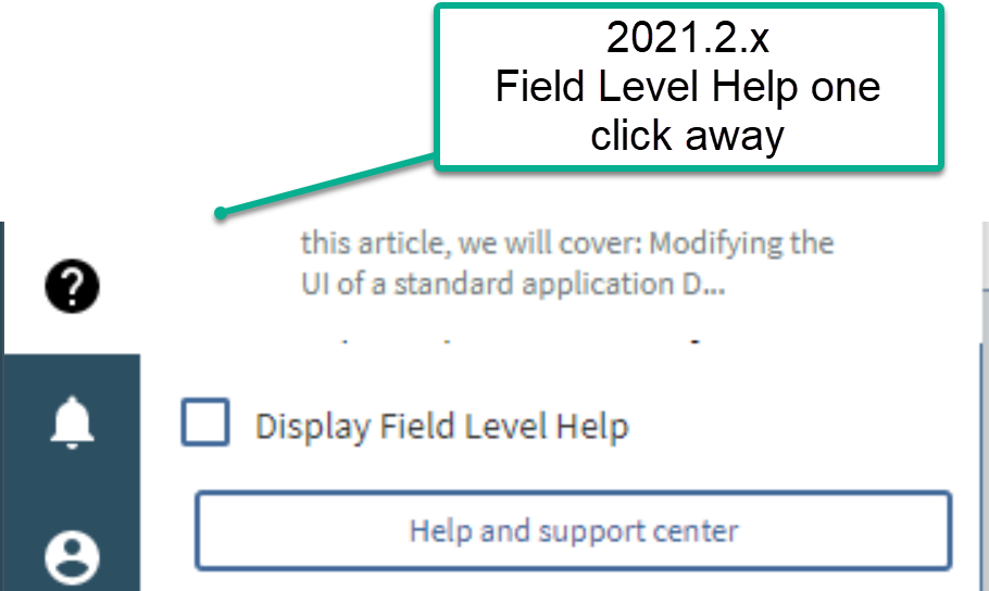

FIeld help is easier to get to now. Just click a box.

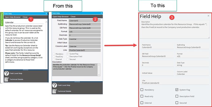

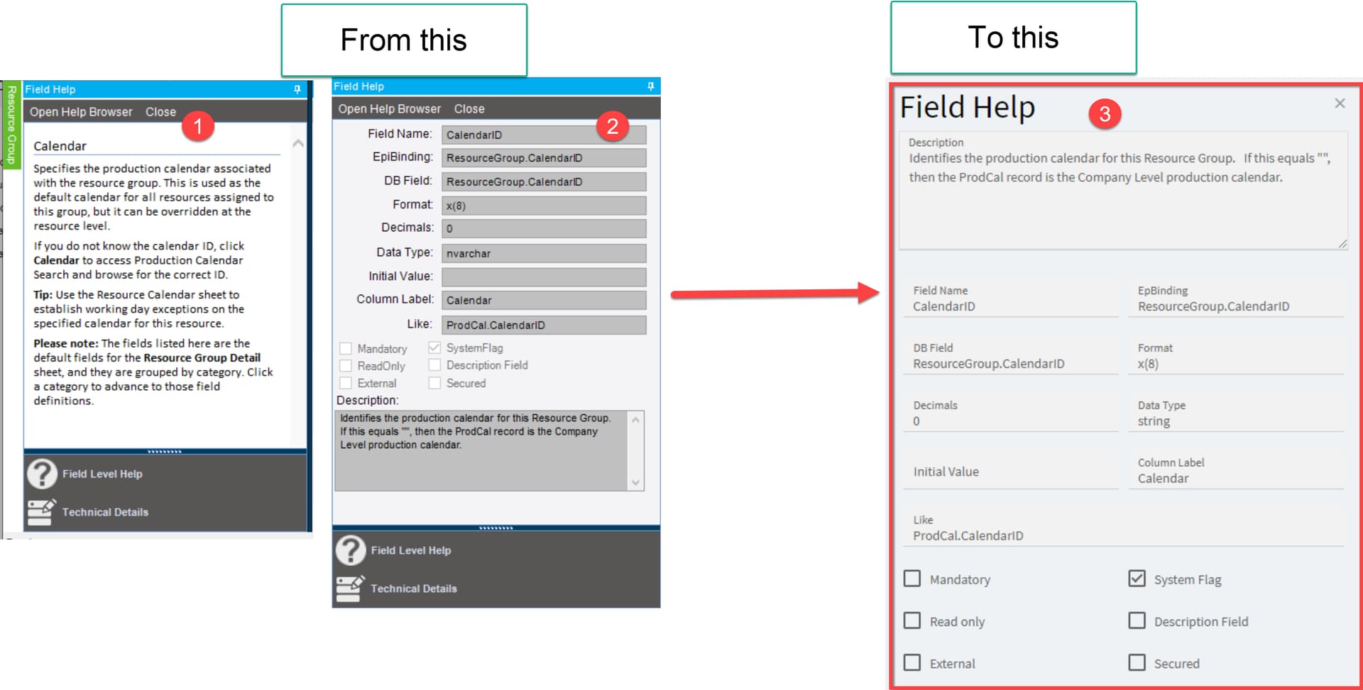

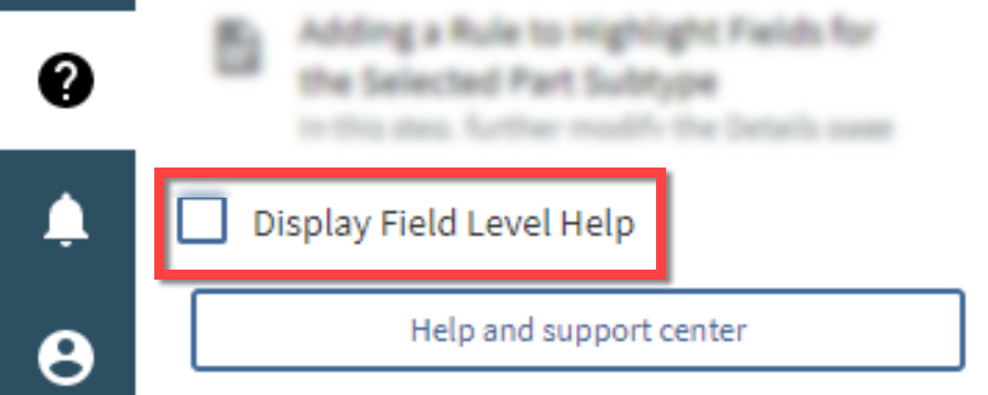

What I would like to know, is what happened to the show help descriptions that E9 brought us with Field help. I’m talking about (1) below, not the technical (2). Kinetic, when you click on field in Kinetic it only brings up (3) technical.

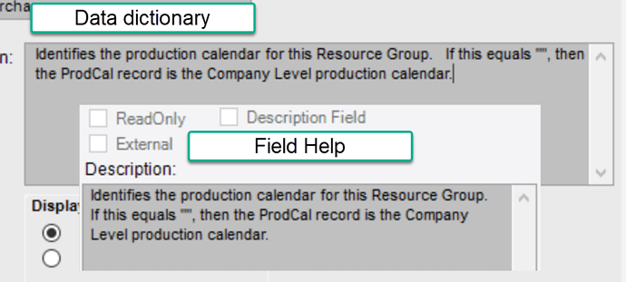

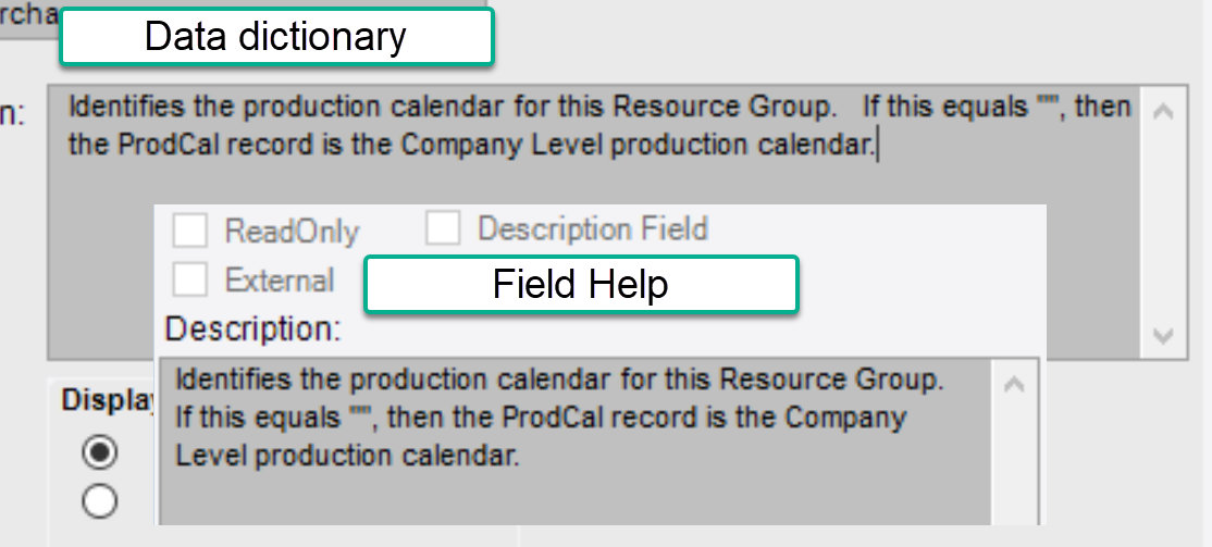

Does Data Dictionary fill the gap?
Data Dictionary is really what the technical view is.
The description is identical.
Showing resource Group Table column - Calender ID

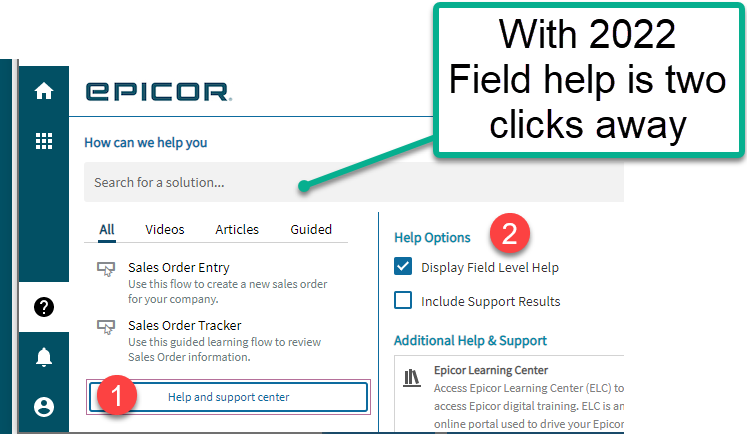

Have you been able to get this checkbox to turn on and stay on for you in the system, or do you have to turn it on each time you logout and log back in?
You have to turn it back on every time you reopen Kinetic.
Epicor must have seen my note - they made it harder now.
You also have to set the checkbox for each screen that you open.
The entire Field Help needs to get a good revamp. Im with you.
