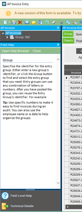

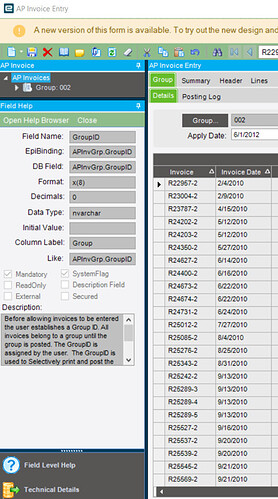

Do you know what happened to the Field Level Help section as what is displaying in the new Field Help is the Technical Details? There used to be two different options under field help - Field Level Help and Technical Details. Field Level Help in some cases gave much more information than the technical details description.

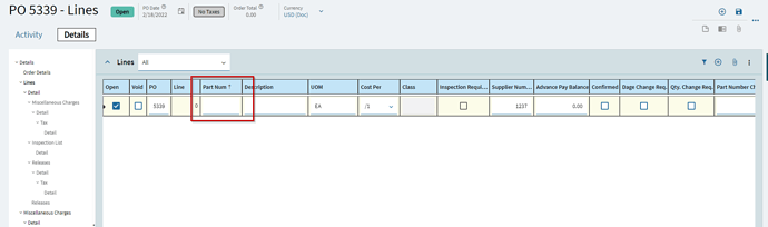

There is supposed to be a checkbox here to toggle field help on:

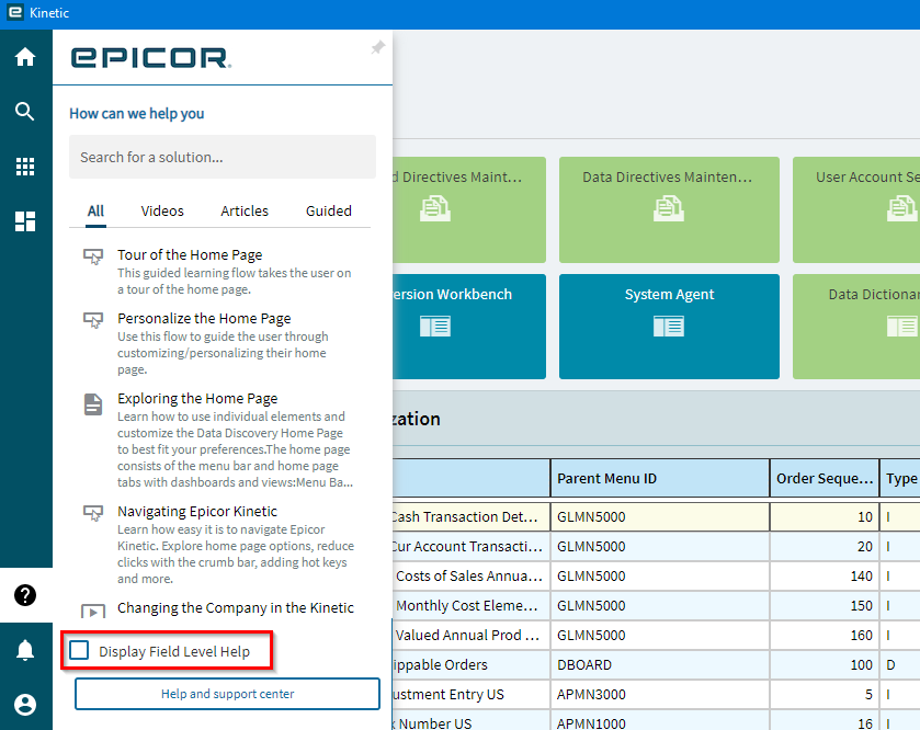

Datapoint - It’s there on my system (on-prem 2021.2.8)

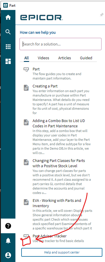

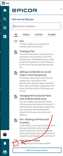

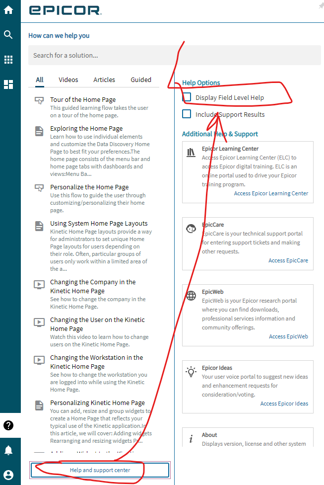

Argh! Found it. Click the “Help and support center” button, the fly-out has the toggle.
