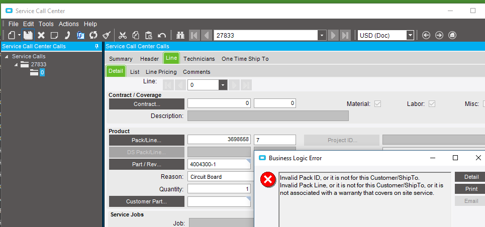

We are wanting to use warranty and service contracts. We more than not ship our products to a customer ship to location vs the primary ship to location. I am now running into an issue where I can’t setup a Field Service Call and reference a specific serial number and pack id/line that was shipped to a different ship to number than what was listed on the pack id.
I am questioning why Epicor will not allow a different ship to number when the customer id is the same for the field service call. Have anyone else ran into this issue and have you found a workaround for it.

No it doesn’t matter on the warranty code in this case. I get the same message just with having a different ship to number.

I believe you can you just change the ship to number on the serial number to match the ship to number you are trying to ship to. We run into this all the time although our issue is keeping the service contract, service call, and serial number customer and ship to in sync. The only time the ship to can be different for us is if the service contract has a blank ship to.
@tanner- I suppose we can do that, however it seems like a very un-necessary step for someone to do each time a FSCall is setup. I’ll have to look for a way to automate it so it just happens for the user.
