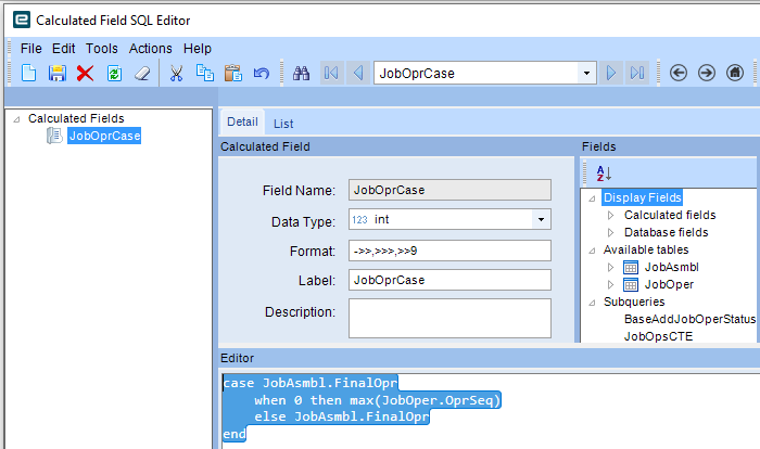

From a recent BAQ example that I was working on…
case JobAsmbl.FinalOpr
when 0 then max(JobOper.OprSeq)
else JobAsmbl.FinalOpr
end
