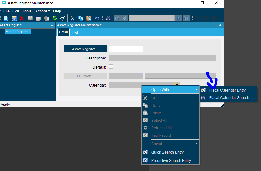

@Sherlin
First you should check which calendar is assigned to the aset register.
Second:- you should check in the Fiscal calendar, whether the next year is defined

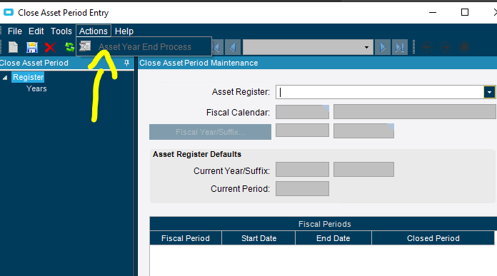

Third:- Open the close asset period entry, select 2021 and process “Asset Year End Process”.
Once completed then select the 2022 by clicking on the fiscal year/suffix.
