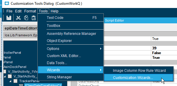

I’m pretty sure you have to use the extended properties to change that. In your customization go to tools, wizards, customization wizards.
Then go to modify extended properties, launch the wizard, find your data view, and data field, choose format, and enter the format that you want. I haven’t messed with this before, so I’m not 100% sure on what to type in for the format, but looking at what’s in the JobOper_DueDate in the view for the customization I looked at, shortyeardate would probably work for what you want. Someone else can probably jump in a give a little better specifics.

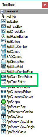

Is this for a native control or a custom control? For custom controls, there is an EpiDateTime Editor that only shows the Date and an EpiTimeEditor for time…

Brian’s suggestion will not work for me, since I have a (custom) control and I want it to show only the date.

Just use the right control for the job as mentioned by @bmgarver and I think you’ll be golden.
