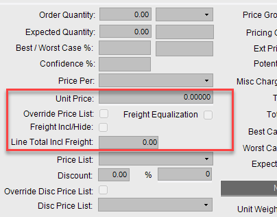

UI Customization for Quote/Order Entry and trackers. Others may be needed depending on where you want to see the values correctly. The customization is pretty simple, and looks like this on Quote Entry
The Unit Price field is untouched. This allows Epicor to process everything normally including customer price lists/etc.
The smoke & mirrors part:
  • The Freight Incl/Hide checkbox needs to be checked if you want delivered price, and it opens the Line Total Incl Freight box, where you enter the Delivered Price.
  • You also create a Header Misc Charge for the freight amount.
  • Alter the RDD to supply the checkbox and delivered price values.
  • Modify the Crystal/SSRS reports, which can be done a few ways but ultimately uses the checkbox as a flag to determine which values to show on a line item and hides/changes the “Misc Charges” value to be zero. At a minimum, you’ll need to alter the quote Line Unit Price, Line Extended Price, and Quote SubTotal/Total fields. All of these could be done a few different ways depending on your preferences, but basically need to change the value displayed based on the checkbox value…
  • You could also make a comment that says “this price includes a delivery charge of $nn.nn” if you want. Some customers wanted that form us, so that is hard coded by customer.
Hope that explains it well enough.
