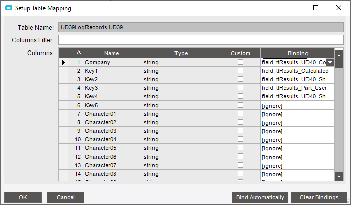

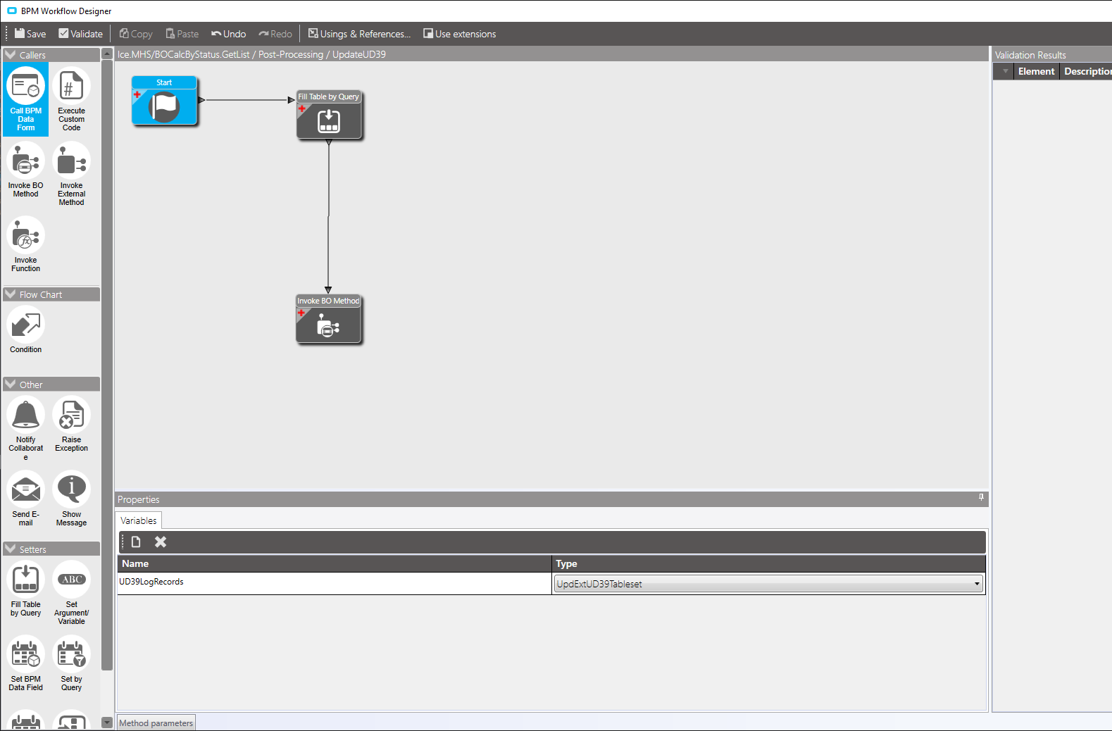

BPM
Set Variable
Populate Fill Table by Query Action values
Set up table mapping
Configure Parameters of the BO Method
As you can see my BAQ populates the UD39 table.
