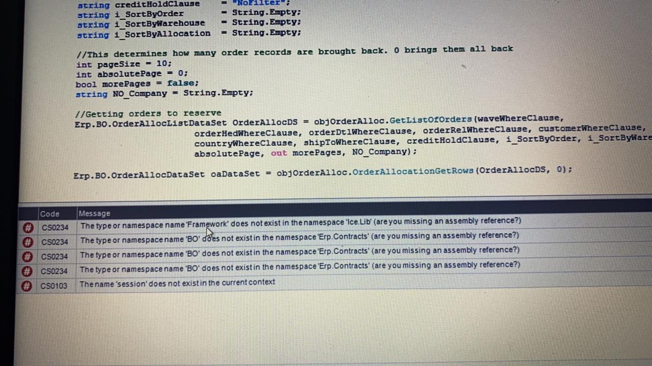

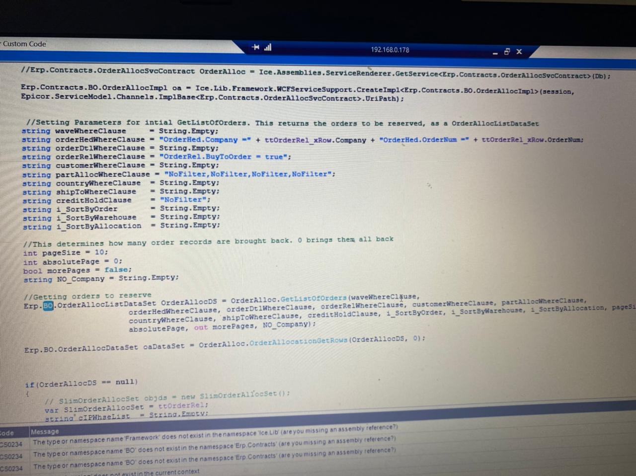

I have pasted this code in BPM and getting an assembly reference issue for your ref screenshot is attached below
The code you pasted is for screen customization, i will share you the bpm code later today.

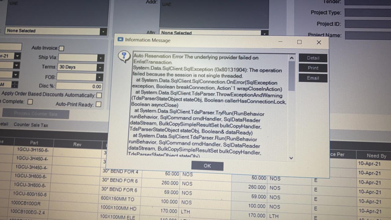

@prakash, I am getting the below-mentioned error while Reserving Parts using Sales Order.
Auto Reservation Error The underlying provider failed on EnlistTransaction.
System.Data.SqlClient.SqlException (0x80131904): The operation failed because the session is not single threaded.
at System.Data.SqlClient.SqlConnection.OnError(SqlException exception, Boolean breakConnection, Action1 wrapCloseInAction) at System.Data.SqlClient.TdsParser.ThrowExceptionAndWarning(TdsParserStateObject stateObj, Boolean callerHasConnectionLock, Boolean asyncClose) at System.Data.SqlClient.TdsParser.TryRun(RunBehavior runBehavior, SqlCommand cmdHandler, SqlDataReader dataStream, BulkCopySimpleResultSet bulkCopyHandler, TdsParserStateObject stateObj, Boolean& dataReady) at System.Data.SqlClient.TdsParser.Run(RunBehavior runBehavior, SqlCommand cmdHandler, SqlDataReader dataStream, BulkCopySimpleResultSet bulkCopyHandler, TdsParserStateObject stateObj) at System.Data.SqlClient.TdsParser.TdsExecuteTransactionManagerRequest(Byte[] buffer, TransactionManagerRequestType request, String transactionName, TransactionManagerIsolationLevel isoLevel, Int32 timeout, SqlInternalTransaction transaction, TdsParserStateObject stateObj, Boolean isDelegateControlRequest) at System.Data.SqlClient.SqlInternalConnectionTds.PropagateTransactionCookie(Byte[] cookie) at System.Data.SqlClient.SqlInternalConnection.EnlistNonNull(Transaction tx) at System.Data.SqlClient.SqlInternalConnection.Enlist(Transaction tx) at System.Data.SqlClient.SqlInternalConnection.EnlistTransaction(Transaction transaction) at System.Data.SqlClient.SqlConnection.EnlistTransaction(Transaction transaction) at Epicor.Data.Provider.EpiConnection.EnlistTransaction(Transaction transaction) in C:\_Releases\ICE\ICE3.2.200.16\Source\Framework\Epicor.System\Data\EpiProvider2\EpiConnection.cs:line 208 at System.Data.Entity.Infrastructure.Interception.InternalDispatcher1.Dispatch[TTarget,TInterceptionContext](TTarget target, Action2 operation, TInterceptionContext interceptionContext, Action3 executing, Action`3 executed)
at System.Data.Entity.Infrastructure.Interception.DbConnectionDispatcher.EnlistTransaction(DbConnection connection, EnlistTransactionInterceptionContext interceptionContext)
at System.Data.Entity.Core.EntityClient.EntityConnection.EnlistTransaction(Transaction transaction)
ClientConnectionId:2ddc0e58-4dc6-4bcd-91c6-8bfc45ac51a3
Error Number:3983,State:2,Class:16
share your code here, this happens if you used outer for loop and change the dataset.

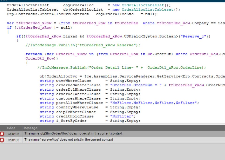

just moved your try catch block out of loop. try below.

I am getting below mentioned error
Try catch block are outside the SlimOrderAllocTableset.
move
SlimOrderAllocTableset objSlimOrderAlloc = new SlimOrderAllocTableset();
under
Erp.Contracts.OrderAllocSvcContract objOrderAllocSvc = null;
define string variable reserveMsg as well.
you need to dispose all the objects.
good practice is to apply the using block
I did the same as you mentioned above but getting the same error

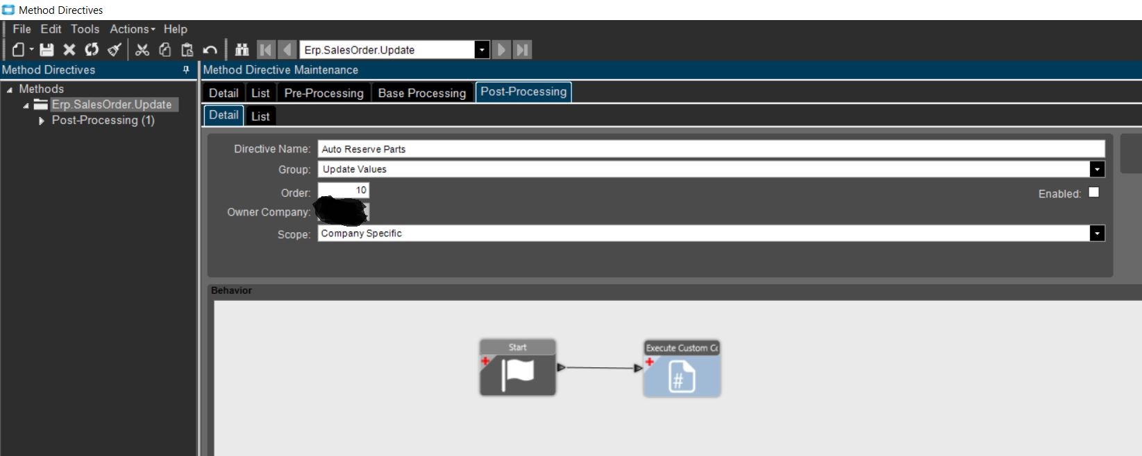

what is the trigger for this bpm?
Try wrapping the whole thing in a Transaction Scope.
