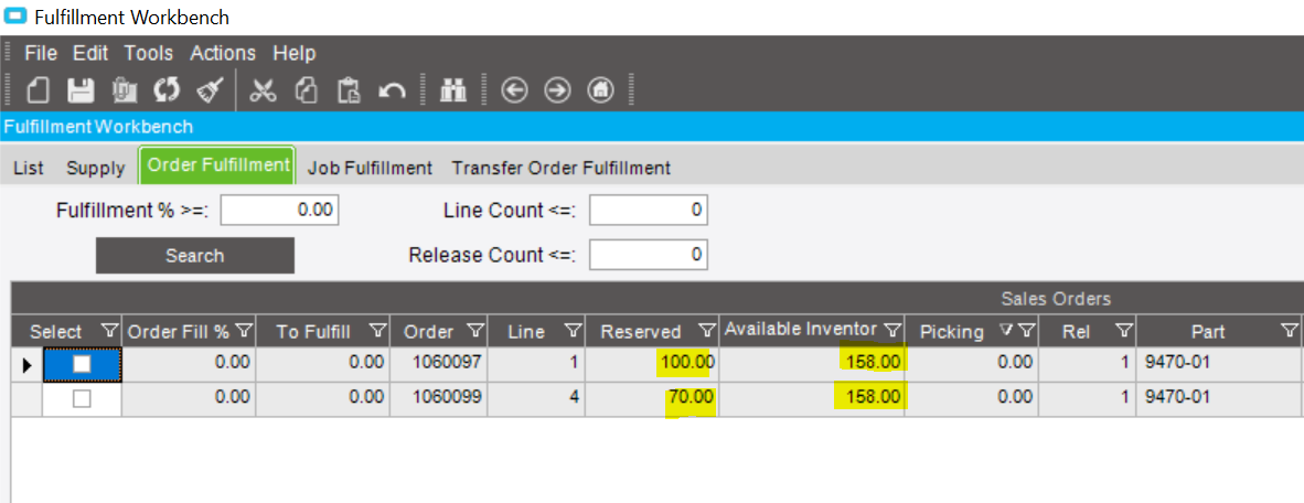

Am trying to automate the Auto-Reserve in fulfillment workbench triggering BPM by Scheduling the System Agent.
The same code is working without any issues in the Customisation on Button Click Event.
In BPM it’s Auto Reserving directly with the Quantity on the Order Release level without considering the On Hand Stock.
Any help on this please
