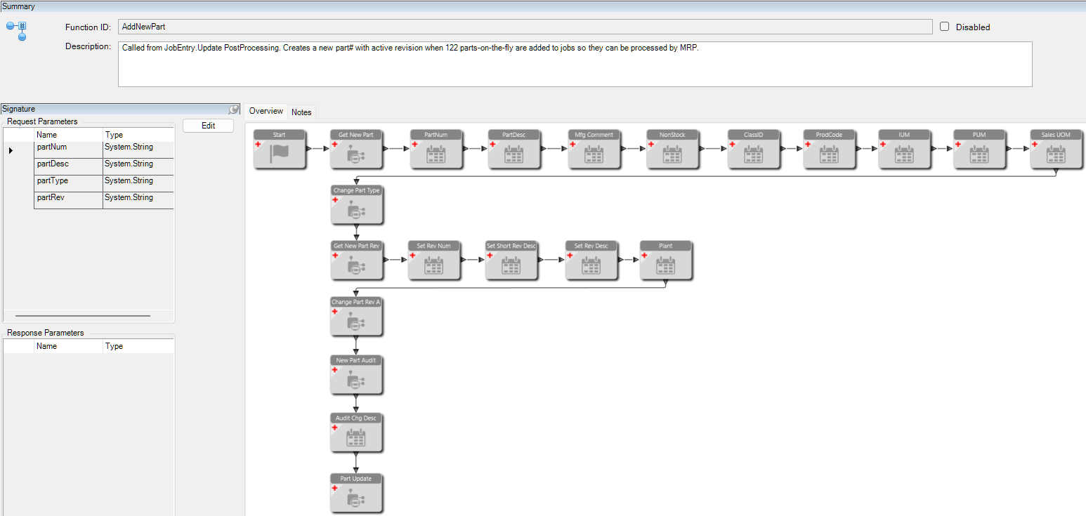

Brand new to functions. I know I’m late to the game, don’t judge me. I made my first one and it does exactly what I want it to do, but I’m curious about your thoughts.
Background - our electrical engineers don’t use CADLink like our Mechs do. When they make a new cable they don’t push it to Epicor to make a part record and will just drop it on the job as a part on the fly. This function will make a part record with an approved rev so MRP can process it properly.
Are functions always this granular? (Call BO, set fields, call another BO, set fields, repeat until the update is called)
Would you have used custom code or widgets like I did? Why?
This is called from a BPM. I can’t figure out for the life of me how to return if it’s successful or not. There are a couple of threads on here about this but I couldn’t get it to work. If anybody knows how to do that please share.
Any other thoughts/advice? I know there are a million ways to do things so I’m generally curious about other ways to go about it.
Neat!
You picked a pretty complex business need for this function so way to go on getting it all setup. Some needs are going to be pretty granular like this use case it’s just the nature of the business.
Probably more support here for custom code than widgets but both are totally valid. It’s what works for you and future maintenance needs.
Agree with Randy here - your approach is totally valid (assuming it works) but could be easier to write as a custom code function rather than using so many widgets.
For simple functions I like to use widgets, but once we get into multiple methods and multiple data fields being set, I lean towards code.
How do you define success? If it’s as simple as “the update BO actually worked,” then just set an output of the function (use the Set Variable widget, or code) to some banal string like “Success!”
Otherwise do try-catch code, or vote for an analogous idea for widgets.
No argument with Brendan and Randy.
I may use the Update by Query widget to do a lot of Set values.
There’s also an Epicor Idea to allow multiple Set Values in a single widget:
Within BPM & Epicor Functions designer, allow the SET widget to set multiple variables/fields - 2553
We had a thread on this earlier this year.
In it, everyone has their own way of doing results. I had a very unpopular Epicor Idea to standardize it.
I just voted, but given your techy description, I have no idea what the actual Idea is. I assume its better than what we have. Maybe you will get more votes if your idea has more description for us plebs… :heart:
The short answer is there is a standard response object for REST calls. Today, each company defines their own method. The Idea is to adopt the RFC standard, so every function has access to a standard response object and each company (and Epicor) could provide better error messages to the users.
