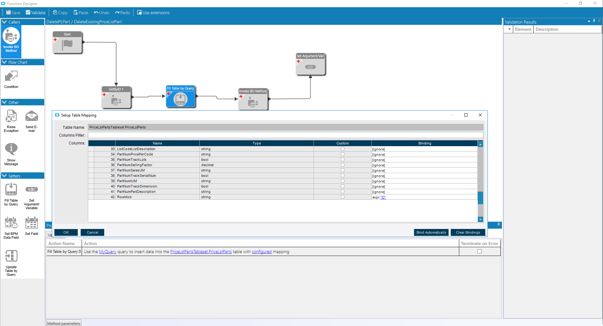

Good afternoon,
I’m trying to create a function that will delete a part number from a price list, but am getting the below error. I searched forum and it seems like this has appeared in BPMs, but not in functions.
I am mimicking the trace log. I used a DeleteByID, which worked AFTER getting a “Delete Not Allowed” error message.
Oddly enough to me, I get the “type exists in both” error only when I am trying to use “Fill Table By Query” to change the RowMod = “D”.
I appreciate any guidance! Thanks!

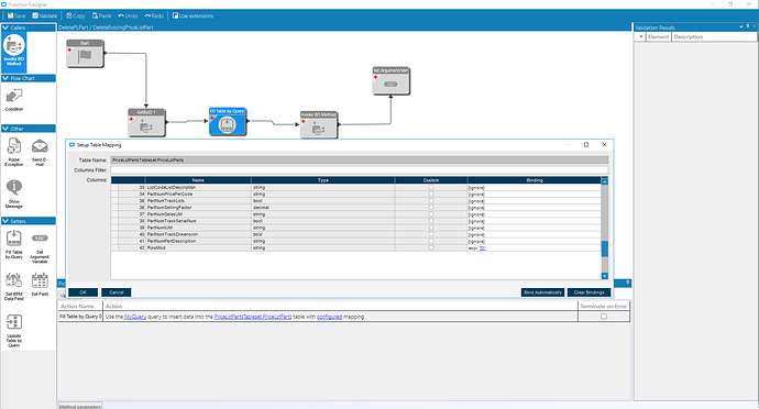

Disregard, I read here that you need to split the function into different libraries.
However, when I Fill Table By Query, map the RowMod field to “D” and call the update, it doesn’t delete.
I appreciate any guidance.

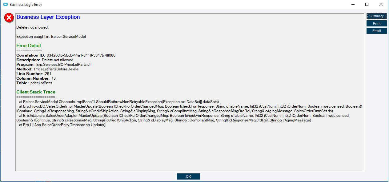

Try to fill SysRowID for that table
Thanks, Olga. Unfortunately I get the “Delete Not Allowed” error again. This time however, it DID NOT delete the part number from the price list.
You cannot use this PriceLst service to delete records, there must be another one, check what is used by the client.
(and maybe change this topic name)
Thanks again, that was it! I had to use ERP:BO:PriceLst
