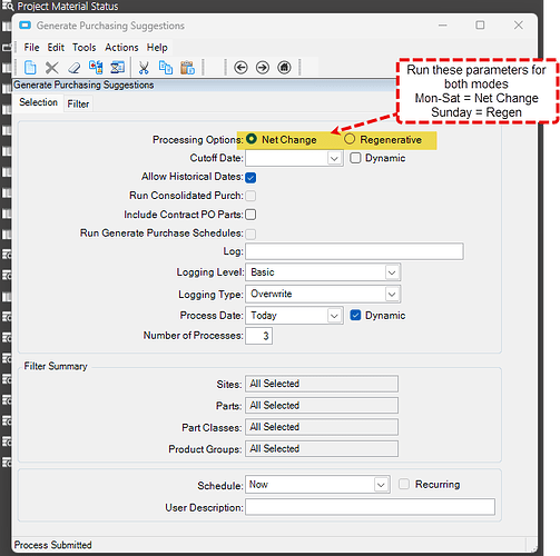

We are currently on version 10.2.600 and recently switched over from running Generate Purchase Suggestions in Regen mode nightly to running Net Change on weeknights and Full Regen mode on Sunday nights.
When we run net change with the above basic vanilla settings (filters wide open), the process fails to generate suggestions for new Purchase Direct materials requirements for engineered and scheduled jobs.

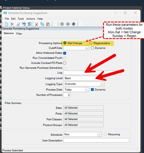

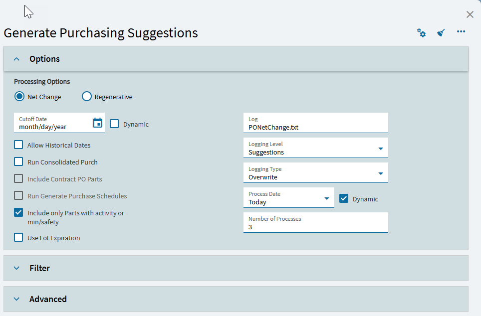

Use the logging and look through that to see if you see anything coming. Set a name, and change the logging level to the highest setting. Then run it, and go find the log in the Epicor Data folder on the server. This should give you some clues as to what’s happening.
