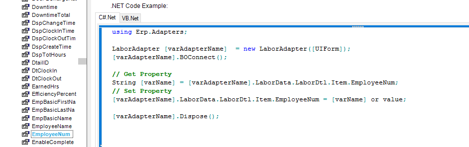

trying to set a string to the Labor EmpoyeeNum
LaborAdapter labor = new LaborAdapter(oTrans.EpiBaseForm);
string empID = labor.LaborData.LaborDtl.Item.EmployeeNum;
What Am I missing here or using this wrong?
@mjbest6288 Here is what I see in Data Objects.

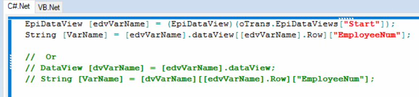

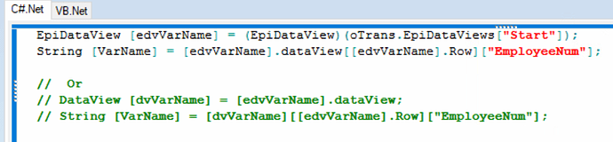

I made that into this in Form_Load
EpiDataView edvStart = (EpiDataView)(oTrans.EpiDataViews["Start"]);
		string empID = (string)edvStart.dataView[edvStart.Row]["EmployeeNum"];
		EpiMessageBox.Show("Employee is " + empID);
