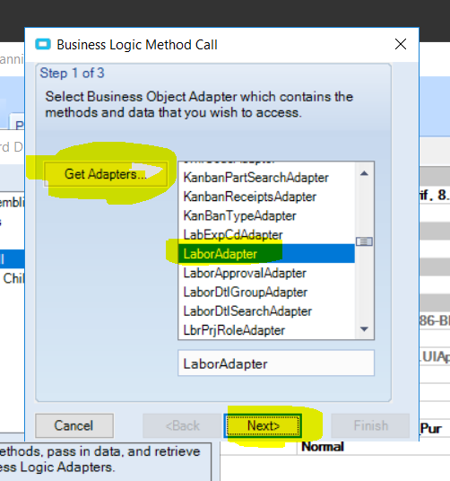

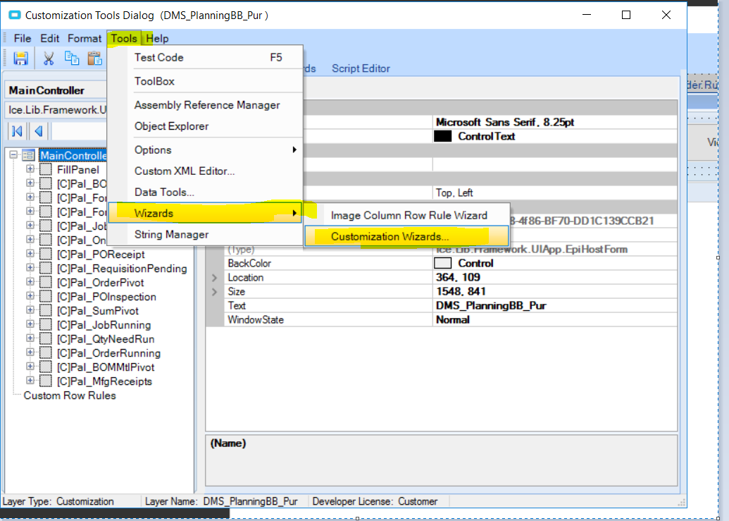

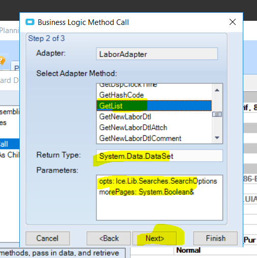

I would like to know if you got the code from the system customization screen or the one you created yourself?
You can use this method to generate your own code to get the data and then edit it to your liking
You can use Business Logic Method Call or Simple Search
here is the generated code:
You edit opts to get according to the condition you want to get out
private void CallLaborAdapterGetListMethod()
		try
			// Declare and Initialize EpiDataView Variables
			// Declare and create an instance of the Adapter.
			LaborAdapter adapterLabor = new LaborAdapter(this.oTrans);
			adapterLabor.BOConnect();
			// Declare and Initialize Variables
			// TODO: You may need to replace the default initialization with valid values as required for the BL method call.
			Ice.Lib.Searches.SearchOptions opts = null;
			bool morePages = false;
			// Call Adapter method
			System.Data.DataSet dsLabor = adapterLabor.GetList(opts, out morePages);
			// Cleanup Adapter Reference
			adapterLabor.Dispose();
		} catch (System.Exception ex)
			ExceptionBox.Show(ex);
