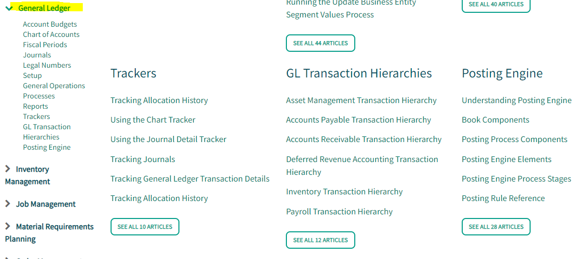

In classic help start at General Ledger
Takes you here… scroll down and you will see several Hierarchy files:
