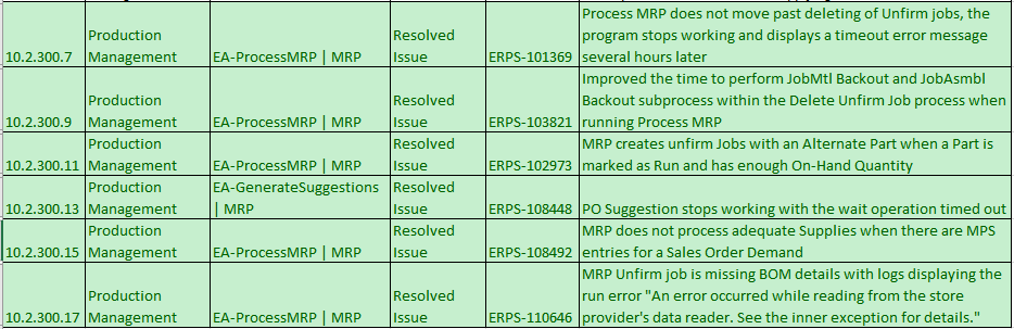

@hkeric.wci do you know what issues to look for on MRP? We are not using right now, but I have one site I just added it to and getting ready to configure and we are currently on 10.2.300.7 for that location.
Its just MRP Crashing, BOM Errors in Logs or simply never finishing an endless loop of âWaiting for JobâŠâ it will be noticeable definitely not a silent issue.
Thanks! The one time have I tried to run MRP in the test system so far it hung with an error and I have just not got back to troubleshooting it. Thanks for the heads up may require a patch routine for both of my 10.2.300 sites from 7 to the latest.
@jeowings Heres the full list .7 - .17
Hey @ERPSysAdmin look at the âPO Suggestionsâ one sounds like the issue you have.
The .7 error is exactly what I am receiving I think. Thanks so much for the summary!
