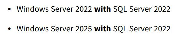

Epicor guides says:
Is this really required or just a nice to have?
What issues will I run into upgrading these servers?
It will be fine from a technical standpoint. It will run. But Server 2016 and SQL 2017 is EOL. Unless you paid for ES. Just as a heads up.
You’ll want to upgrade to a newer versions as even Microsoft has them on extended support now. Could you run 25.2 on what you have? Sure, but why take the risk as 2027 is coming soon?

Following up on this. Should i do an in place upgrade of windows and Sql server or do a new VM and fresh install of both and restore from a back up for the DB?
I never do in place upgrades. I always find it cleaner to install fresh and restore. Too many weird issues with in place upgrades.
thats what i was thinking too.
