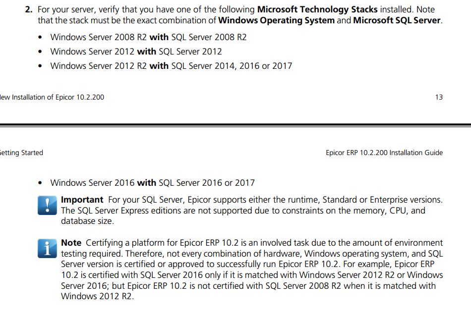

We are starting to plan an Upgrade from 10.1.400 -> 10.2.200
Currently on Windows Server 2012 and SQL Server 2012.
Should I install everything on Windows Server 2016 with SQL Server 2017?
Or is it not worth the extra effort?

Apparently 2017 isn’t Epicor certified yet.
Latest and greatest on EPICOR Certifed.
That’s what we saw here. When @rapat_mark asked epicor for the latest version of SQL they sent him 2016.
Which version SQL Server 2016 SP 2?
? I’m not sure.
SQL Server isn’t something you want to change version on again soon after doing an upgrade.
I would go for 2017, it’s a supported config - jump in two feet, you can test the water for the rest of us @knash
