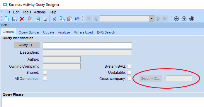

Maybe better, you can assign security to the underlying BAQ.

A. Will the Security ID pass thru to the Dashboard?
B. If it does, will that enable JaneDoe to see the Dashboard even though she does not currently have access to Dashboards?
Why aren’t you doing this with menu maintenance?
A. Yes.
B. @Banderson is correct. You’d create a menu item with a security group that one JaneDoe is in. That controls Menu access. You can put it in any folder of the menu tree and only people in that group would see it.
