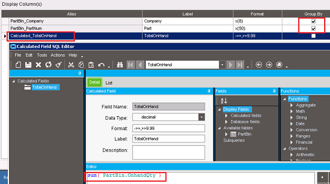

ideally I want to combine the SKU’s so single SKU with the combined on hand stock so in this situation 82
bordway
(Bruce Ordway)
2
Without more detail I can only guess - group the part field and add a calculated field for the total qty. Ref screenshot.
