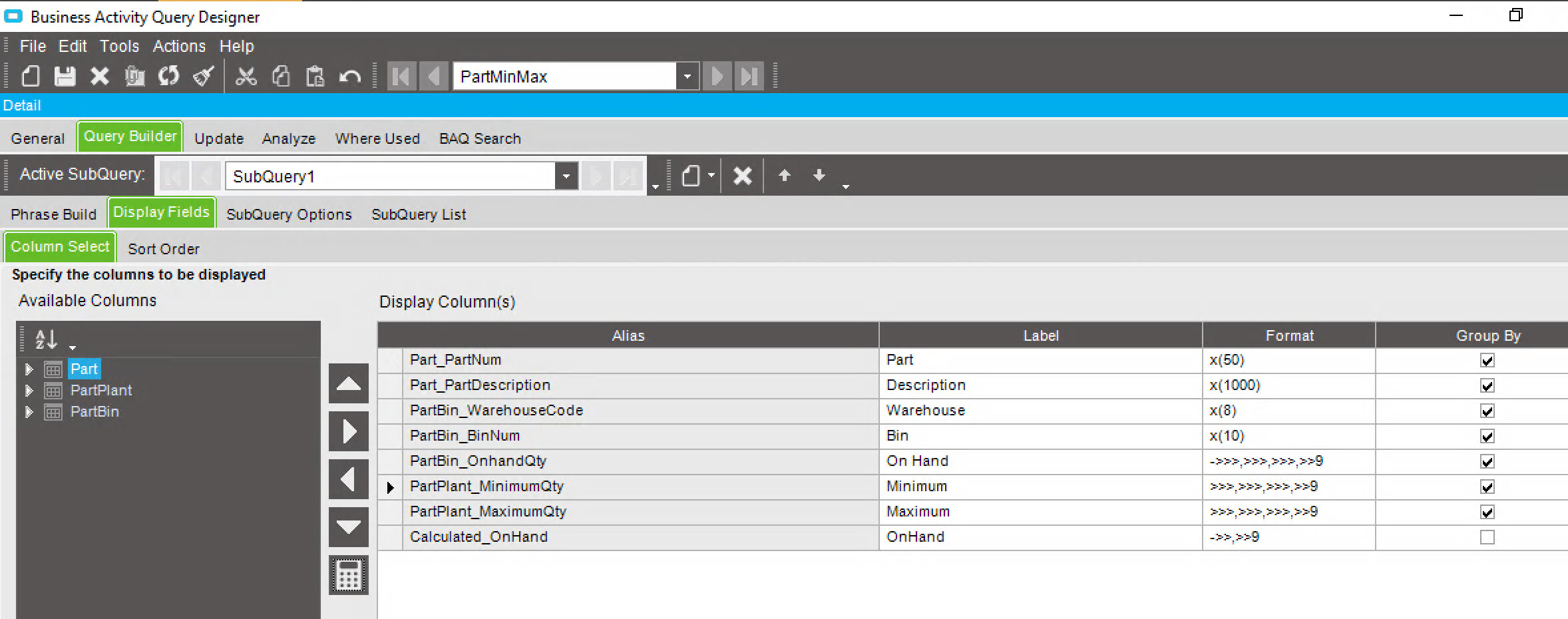

It is a simple BAQ. I think that I understand what you are saying but am not sure how to implement it. If I do this, then I get an error when trying to run the BAQ:
You will need to create a calculated field to show the total on-hand quantity using the sum() function. Then mark the Group By checkbox for every other column you don’t want to sum up. You will need to remove BinNum from your query.

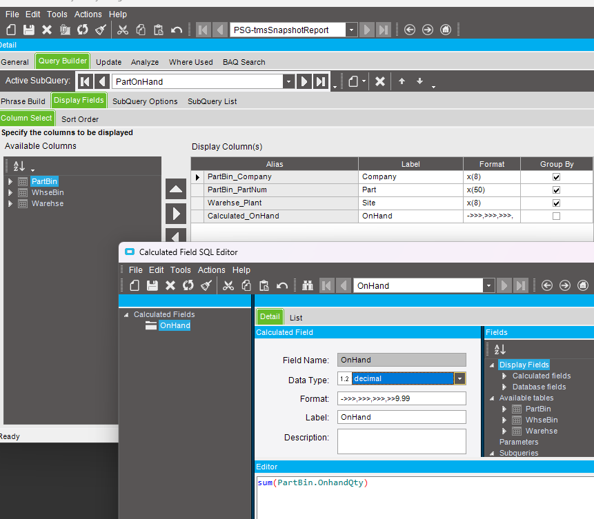

This is the query we use for on-hand quantity by part and plant:

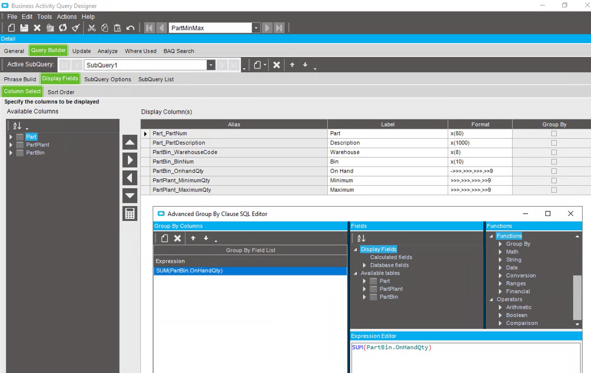

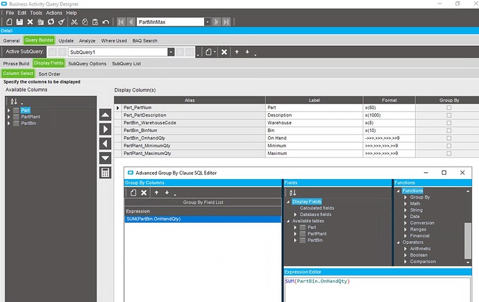

Ah ok. I was trying to use that Advanced Group By button down on the bottom instead of just checking the Group By boxes. It works now. Super simple now that I know how to do it! Thank you!
