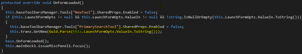

Bear in mind, the oldest version I have is 10.2.300 at the ready so it may not match, but I checked the source. The value from the launch form options is out of sorts on your end for the record it is trying to pull via context. Since this happens after the form loads, you can likely get the information in the customization. Likely can pull it from a BPM as well, but not certain off the top of my head which BO to check specifically.
Even if it doesn’t get me past the error, I can use this to pull up the record I need. I should have checked the LauchFormOptions but I assumed (yes, I should know better than to assume) that Epicor was using a different field of its own to accomplish this rather than the one I would have to use to send it.
