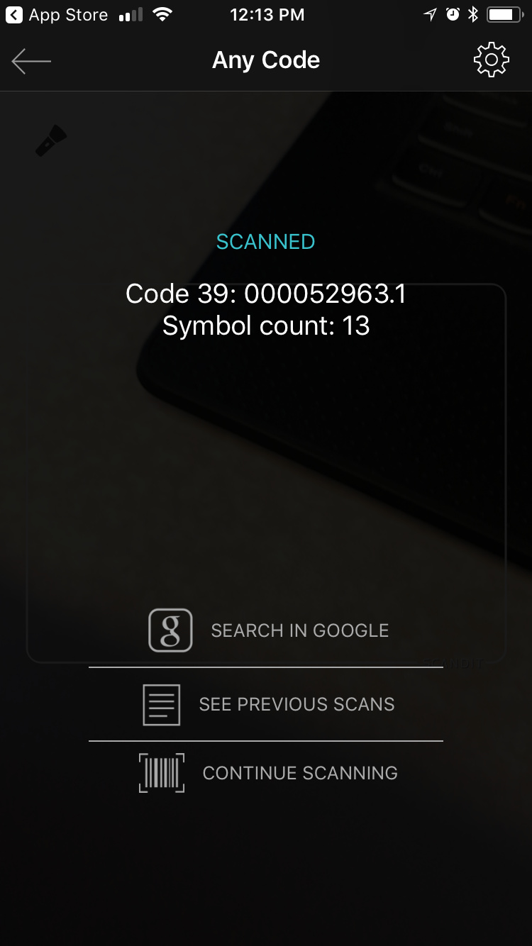

SCANDIT is a free app available on iOS, Android and Windows, that uses your phone camera to scan the codes. Here is their website page of free apps:
Just scan any barcode and it shows you the barcode type & the data:
I have found that it can scan a wide array of codes and it’s free.
