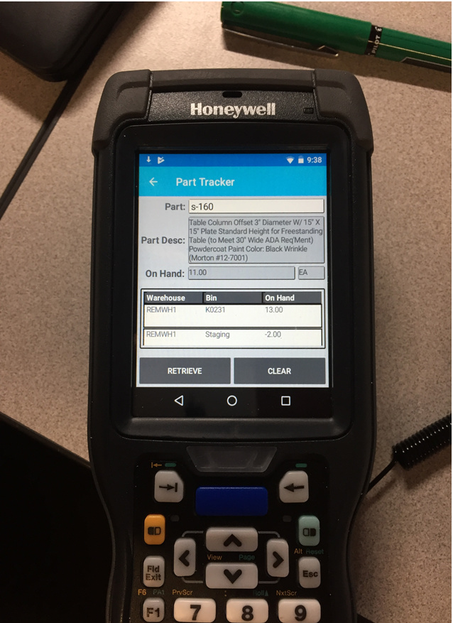

I’m working on designing an Android app using Xamarin and REST, so I don’t need to use RDP.
It’s slow going, though, since it’s a pet project.

Please let me know when you’ve got it to a good point to test!
I’ve got Part Tracker and PO Receipt working so far.
Working on Inventory Transfer and Move WIP next.
(I ended up reducing the size of that part description box and making it scrollable to show more of the on hand grid)

The perk of me doing my own is it’s 100% customizable and doesn’t cost the company any additional money.
I agree wholeheartedly, if you have the time and resources it makes sense.
Not to mention it helps with the upgrade pain.
