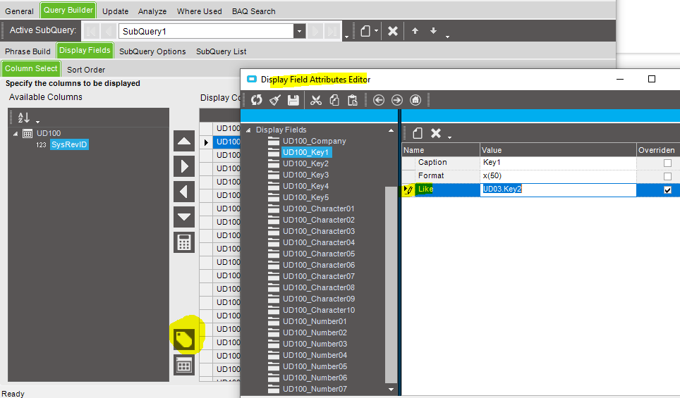

I wonder if in the BAQ you have to edit the field attributes and set a Like
I did used the Data Tools to add a Custom Column Like - or does that not have the same effect?
I just tried what you suggested - no change that I could notice. Do you have a working example I could import?
