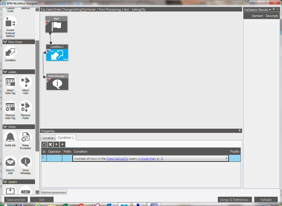

I set up a condition "Number of rows in the (Query) query is more than 0.
In the query i set up:
ttOrderDtl connected to ERP.PartWhse Company to Compant and PartNum to PartNum.
On ttOrderDtl, I did a table criteria: SellingQuantity >= PartWhse.OnHandQty
On ERP>PartWhse table, I did a table criteria: WarehouseCode = “3”
I have the condition connected to a pop-up message telling me it is working.
It seems to just trigger all the time, even when the on hand is larger than the selling qty.
Any ideas?
(EDIT): I finally got it working thanks to @Banderson. I changed SellingQuantity >= PartWhse.OnHandQty to SellingQuantity > PartWhse.OnHandQty. That seems to have fixed it.

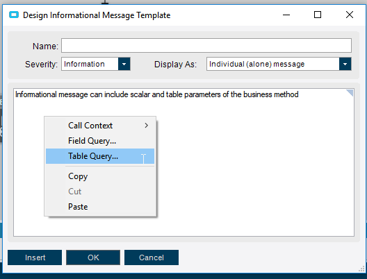

in your popup, do a table return to see what’s in ttOderDtl. Do you know how to do that?
Nope, just 1 line to test with.
Not sure, how do you do it?
in your message, right click, table query, pick some fields so you can identify some stuff. This should help you figure out if your criteria are working correctly
It looks like the query creates 1 line.

I set it up the same way you set it up and it’s working for me. I set it up on SalesOrder.Update on per-processing. It seems odd though that it wouldn’t work on ChangeSellingQty.
Can you show me the part tracker screen of the part you are trying to check against? And the order line screen you are saving? And the rows that are coming back in your message?
