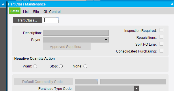

Could you use the part class feature for that? or will they end up at 0 too often and not below 0?

Thanks! I think we could do this, but we’re wanting to provide a more explicit message. Is there any way to customize the message that comes up for this?
The overall message very likely using the translation text tools, but conditionally depending on the class or type of transaction you maybe could do it through BPM depends on how Epicor is signaling that message.
