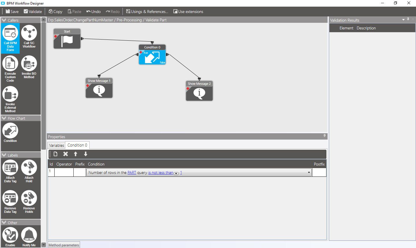

Hi,
I have a simple BPM that shouldnt have taken me the entire day to figure out. I want the BPM to throw an exception in Sales order entry if the part doesnt exist in the Part table. To simplify things, i am just trying info message that says true when the part is in part table and false when is not. i can only get it to say either true or false for both real and fake parts. what am i doing wrong??
When i enter a part in sales order entry i get the same message whether the part exist in Part table or not.
driving myself crazy!

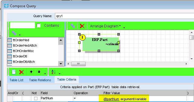

To troubleshoot, I’d suggest just placing a message box to display the part numbers in the ttTable. From there query your Part table to ensure that what you think does not exist, doesnt.
Try the following as your query:
Because …
The tt tables aren’t updated until the after the ChangePart is complete. In other words, the tt tables in pre-processing, still have the previous values.
I found this by putting a Show Message block right after the Start block, like @Chris_Conn suggested.
With the fieldQuery of ttOrderDtl.Partnum displayed in that show msg, it always shows the value it is being changed from.
  • For a new Order Line, it will be blank.
  • Changing an exist Order Line, it shows the previous value.
EDIT: Your query that checked the ttOrderDtl and Part, would have worked as a Post Processing directive.

THANK YOU! i would have thought that since it was showing in vantage in pre-processing, it would show to. appreciate the help!
