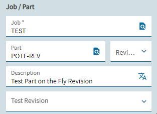

I’m hoping someone can help in testing a bug. Support says they cannot reproduce in their version (2022.1.15) but it is happening in my version (2022.1.11). If anyone has either of these versions and can test for me, it is appreciated.
The bug is in the Kinetic UI only, both web and client. You cannot enter a Rev for a part on the fly. This is in Quote, Order, and Job. Additionally, you cannot change a Rev. Client screen in old UI works.

I can confirm that I also see this issue in 2022.1.10, 2022.1.14, and 2022.2.4
It looks like the Rev dropdown is not set up to accept user-defined values. It must exist in the list, which for Part on the Fly obviously there is nothing to select.

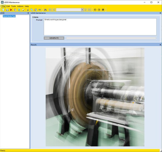

I submitted a ticket to this effect back in May 2022. They closed and gave me a problem: PRB0250509 I never looked back to see if they did anything with it. HAH! The problem record says, “not found”. That about sums it up I guess… EDIT: I found the problem ticket. It has been rejected. So, I would say this is working as designed! :stuck_out_tongue:

It’s just an oversight on Epicor’s part. Their ‘Part Rev Description’ component doesn’t allow custom values in the Rev combobox, but it should.
In Application Studio I added a combobox, enabled ‘Allow Custom’, and bound it to the JobHead.RevisionNum field. It works as expected.
@jkane you might be able to use this as a workaround until Epicor (hopefully) fixes this.
