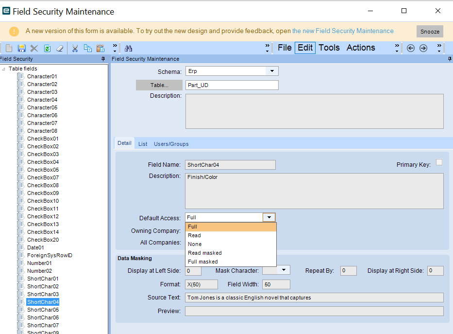

Take a look at Field Security Maintenance Data Masking section, see if that suffices.
@anuxoll
Yes, do as @hkeric.wci says,
Field security works on UD fields, you just need to specify the UD table with ‘_UD’ (see below). Then select the type of masking you need in the Default Access and then set the masking specifics. Way easier than messing with BPM’s and missing a trigger that exposes your data.
Watch out with the masking though. We tried it, and it ended up writing the masked value to the database. So make sure you test first.
We are trying to hide Epicor calculated fields such as EstLaborCost which does not show up on field security unfortunately.
