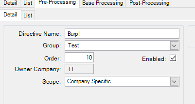

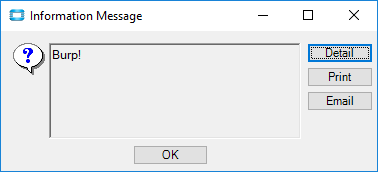

  PublishInfoMessage(this.Name,Ice.Common.BusinessObjectMessageType.Information, Ice.Bpm.InfoMessageDisplayMode.Individual, string.Empty, string.Empty)
Better yet one of those two empty strings at the end of that call is the Title of the box.
But is that really easier than just typing in a string that says where the BPM is? Cooler in nerdtastic kinda way, sure, but seems a little convoluted doesn’t it?
Seems to work :slight_smile: Thanks @Chris_Conn

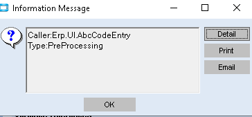

How about this: :smiley:
var t = this.Type.ToString();  //pre, base, post
var an =this.callContextClient.AssemblyName; //the calling form
What? Cant include the specific method?
