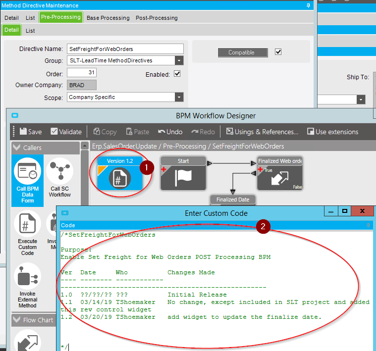

BUT LATELY, I have started adding version control & Comments directly into a BPM C# widget that is reserved for this purpose. (no code allowed per my rules). It is a detached widget (exception… see below).
When CHANGING or CREATING a BPM I do the following:
  1. create a C# Widget to hold the purpose and versioning information… update the version in the header of the widget. Make the Corner color of this widget ORANGE (to highlight it).
  2. document the purpose inside the widget with history.
When DISABLING the BPM, I do the following:
  1. put it into a special group so that when it gets moved to live, we know that it SHOULD be disabled.
  2. Disable it
  3. Disconnect the Start Widget from the main flow (just in case someone accidentally enables it)
  4. Modify my Version Widget so it says Disabled and turn it RED.
  5. Update the comments in the version widget with details.
NOW… When you move these into from TEST into LIVE, you can actually see which version has been moved:
  • Is the right version in Live? (yes, you can compare version numbers).
  • is it supposed to be disabled? (yes, you can see that now).
Of course, someday, we hope that someone will add a “Notes” or “Comments” tab to the BPM maintenance program… (safe harbor)

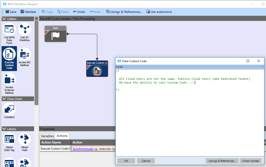

@Mark_Wonsil: image
Should be: “All Cloud users are treated equal. But some are more equal than others”
Trying to decide if that’s an MT threat or not…
